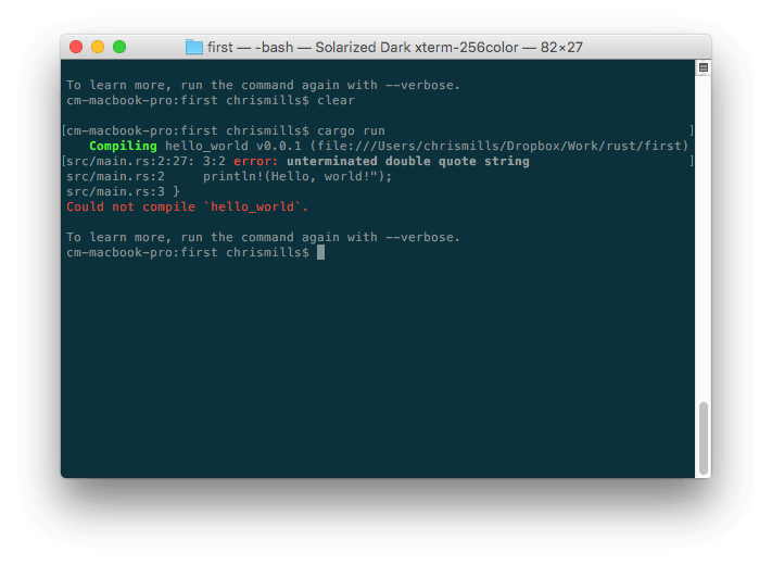

When writing code of some kind, everything is fine, until that dreaded moment when an error occurs — you've done something wrong, so your code doesn't work — either not at all, or not quite how you wanted it to. For example, the following shows an error reported when trying to compile a simple program written in the Rust language.
A console window showing the result of trying to compile a rust program with a missing quote around a string in a print statement. The error message reported is error: unterminated double quote string.
Here, the error message is relatively easy to understand — "unterminated double quote string". If you look at the listing, you can probably see how println!(Hello, world!"); might logically be missing a double quote. However, error messages can quickly get more complicated and less easy to interpret as programs get bigger, and even simple cases can look a little intimidating to someone who doesn't know anything about Rust.

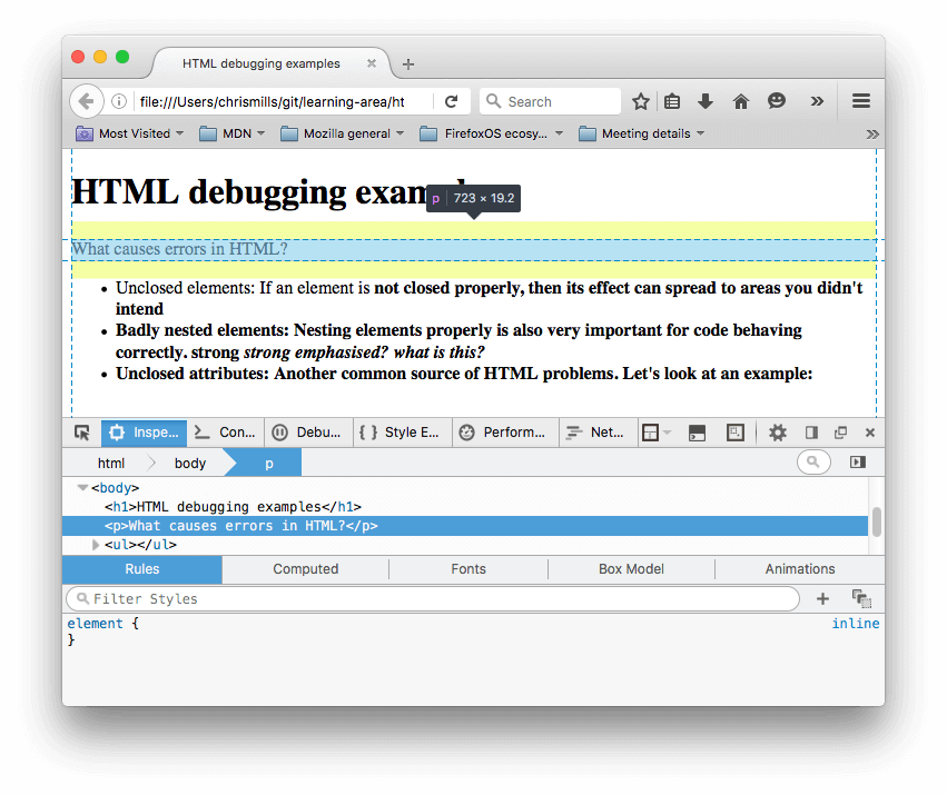

Using a DOM inspector
All modern browsers have a set of developer tools (devtools) built into them, which provide a set of functionality for examining the webpage loaded into the current tab. These can show you what HTML is rendered in the page, what CSS is applied to each DOM node, what JavaScript is running in the page, and more. They also allow you to edit the currently-running code and see the effect live on the page.
You can open the devtools in a similar way in each browser — see How to open the devtools in your browser to learn how.
For this article, the only relevant devtools function is the DOM inspector, which shows the currently-rendered HTML DOM and allows you to edit it. Let's look at this now:
  1. Open the devtools in your browser.
  2. Open the DOM inspector. It is in the same place in each browser — the first tab in the devtools at the start of the row. In Firefox it is labelled Inspector, while in Safari, Edge, and Chrome it is labeled Elements. This should be the tab selected by default when you first open the devtools, but select it if it isn't.
  3. Examine the DOM tree structure shown in the tab, and note how you can click the little expansion arrows at the start of each DOM node to expand and collapse them and reveal their descendant nodes. You can also use the up and down cursor keys to move up and down the nodes, and the right and left cursor keys to expand and collapse the nodes.
  4. Also try hovering over the nodes (or selecting them with the cursor keys) and note how the currently-hovered (or selected) element is highlighted in the viewport.
  5. You can also edit the rendered DOM. We won't use the editing functionality in this article, but take some time to look up how to do this if you are curious.

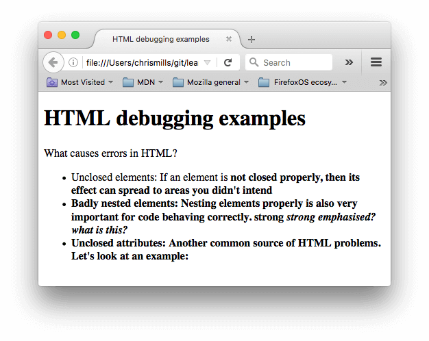

  2. Next, open it in a browser. You will see something like this:A simple HTML document with a title of HTML debugging examples, and some information about common HTML errors, such as unclosed elements, badly nested elements, and unclosed attributes.
  3. This immediately doesn't look great; let's look at the source code to see if we can work out why (only the body contents are shown):
    html
    <h1>HTML debugging examples</h1>
    <p>What causes errors in HTML?
    <ul>
      <li>Unclosed elements: If an element is <strong>not closed properly,
          then its effect can spread to areas you didn't intend
      <li>Badly nested elements: Nesting elements properly is also very important
          for code behaving correctly. <strong>strong <em>strong emphasized?</strong>
          what is this?</em>
      <li>Unclosed attributes: Another common source of HTML problems. Let's
          look at an example: <a href="https://www.mozilla.org/>link to Mozilla
          homepage</a>
    </ul>
  4. Let's review the problems:
    • The paragraph and list item elements have no closing tags. Looking at the image above, this doesn't seem to have affected the markup rendering too badly, as it is easy to infer where one element should end and another should begin.
    • The first <strong> element has no closing tag. This is a bit more problematic, as it isn't easy to tell where the element is supposed to end. In fact, the whole of the rest of the text has been rendered in bold.
    • This section is badly nested: <strong>strong <em>strong emphasized?</strong> what is this?</em>. It is not easy to tell how this has been interpreted because of the previous problem.
    • The href attribute value is missing a closing double quote. This seems to have caused the biggest problem — the link has not been rendered at all.
  5. Now let's examine the rendered DOM, as opposed to the source code. To do this, open your browser's DOM inspector. You will see a representation of the rendered markup: The HTML inspector in Firefox, with our example's paragraph highlighted, showing the text "What causes errors in HTML?" Here you can see that the paragraph element has been closed by the browser.
  6. Look at how the browser has tried to fix our HTML errors (we did the review in Firefox; other modern browsers should give the same result):
    • The paragraphs and list items have been given closing tags.
    • It isn't clear where the first <strong> element should be closed, so the browser has wrapped each separate block of text in its own <strong> element, right down to the bottom of the document!
    • The incorrect nesting has been fixed by the browser as shown here:
      html
      <strong>
        strong
        <em>strong emphasized?</em>
      </strong>
      <em> what is this?</em>
    • The link with the missing double quote has been deleted altogether. The last list item looks like this:
      html
      <li>
        <strong>
          Unclosed attributes: Another common source of HTML problems. Let's look
          at an example:
        </strong>
      </li>

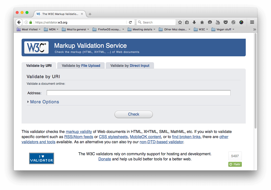

HTML validation
You can see from the above example that you really want to make sure your HTML is well-formed! But how? In a small example like the one seen above, it is easy to search through the lines and find the errors, but what about a huge, complex HTML document?
The tool for this job is the Markup Validation Service (or HTML validator), which is created and maintained by the W3C (which you learned about in The web standards model). The validator takes an HTML document as an input, goes through it, and gives you a report to tell you what is wrong with your HTML.
The HTML validator homepage
To specify the HTML to validate, you can provide a web address, upload an HTML file, or directly input some HTML code.

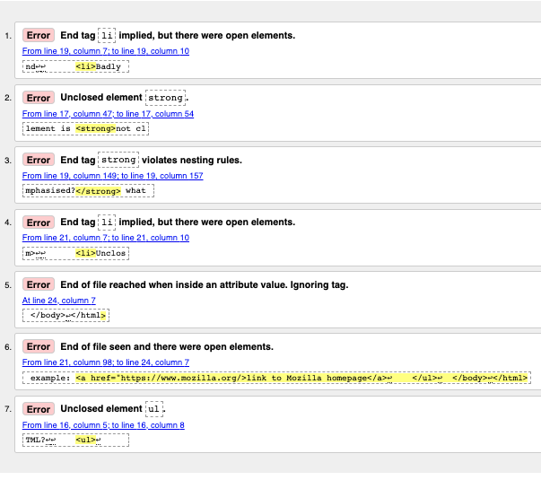

This should give you a list of errors and other information.
A list of HTML validation results from the W3C markup validation service
Interpreting the error messages
The error messages are usually helpful, but sometimes they are not so easy to understand. With a bit of practice, you can work out how to interpret these to fix your code. Let's go through the error messages and see what they mean. You'll see that each message comes with a line and column number to help you to locate the error easily.
  • "End tag li implied, but there were open elements" (2 instances): These messages indicate that an element is open that should be closed. The ending tag is implied, but not actually there. The line/column information points to the first line after the line where the closing tag should really be, but this is a good enough clue to see what is wrong.
  • "Unclosed element strong": This is really easy to understand — a <strong> element is unclosed, and the line/column information points right to where it is.
  • "End tag strong violates nesting rules": This points out the incorrectly nested elements, and the line/column information points out where they are.
  • "End of file reached when inside an attribute value. Ignoring tag": This one is rather cryptic; it refers to the fact that there is an attribute value not properly formed somewhere, possibly near the end of the file because the end of the file appears inside the attribute value. The fact that the browser doesn't render the link should give us a good clue as to what element is at fault.
  • "End of file seen and there were open elements": This is a bit ambiguous, but basically refers to the fact there are open elements that need to be properly closed. The line numbers point to the last few lines of the file, and this error message comes with a line of code that points out an example of an open element:
    example: <a href="https://www.mozilla.org/>link to Mozilla homepage</a> ↩ </ul>↩ </body>↩</html>
    Note: An attribute missing a closing quote can result in an open element because the rest of the document is interpreted as the attribute's content.
  • "Unclosed element ul": This is not very helpful, as the <ul> element is closed correctly. This error occurs because the <a> element is not closed, due to the missing closing quote mark.
If you can't work out what every error message means, don't worry about it. A good strategy is to fix a few errors at a time, then revalidate your HTML after each set of fixes to show what errors are left. Sometimes, fixing an earlier error will also get rid of other error messages — several errors can often be caused by a single problem, in a domino effect.
You will know when all your errors are fixed when you see a nice little green banner telling you there are no errors to report. At the time of writing, it said "Document checking completed. No errors or warnings to show."
